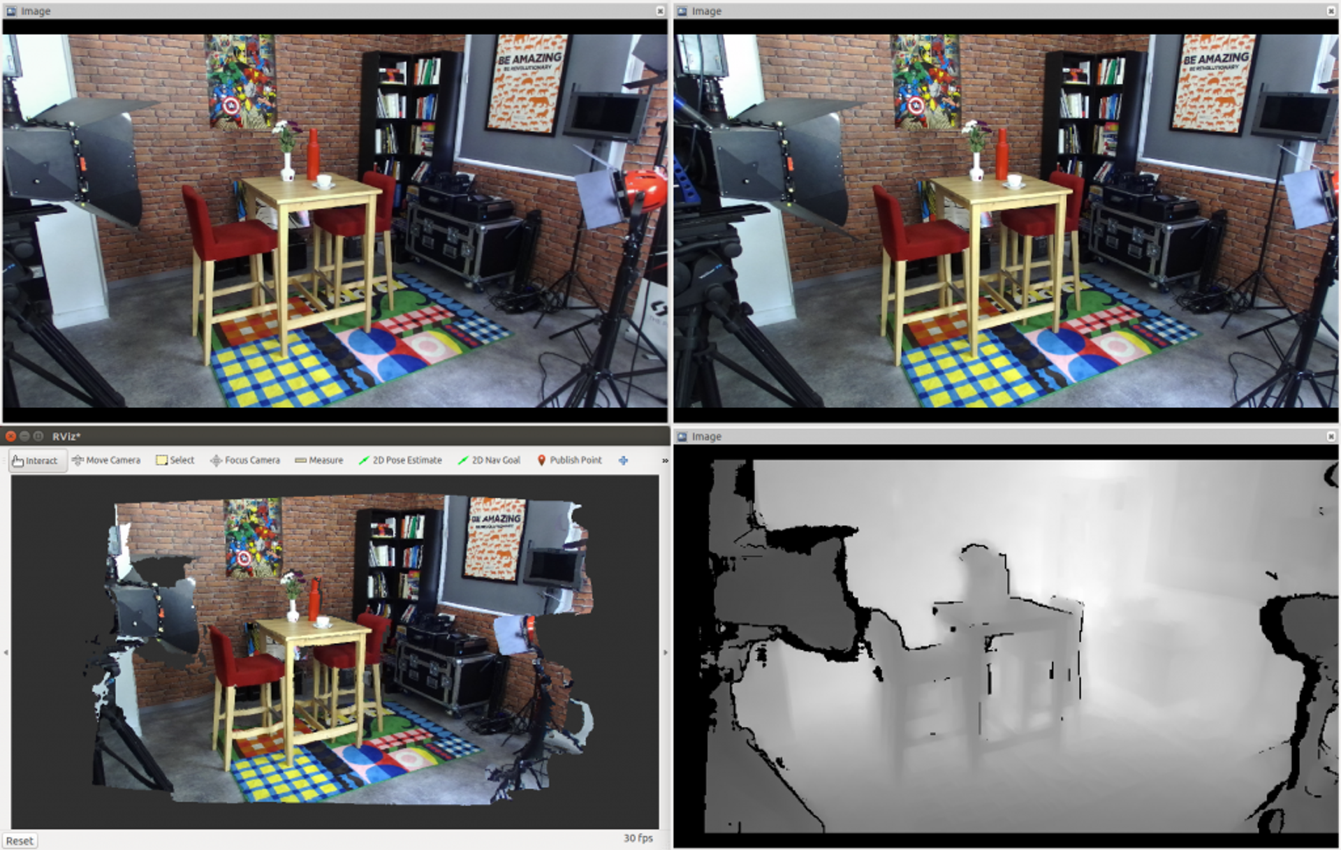

You can easily display ZED images and depth using rviz or rqt_image_view. Just select a topic in the rqt GUI to display it in the main window.
To display the point cloud, launch the rviz visualizer with the following command:
rosrun rviz rviz
Now move your mouse to the top left of the rviz window and select zed_initial_frame in Displays->Global Options->Fixed Frame.
Click on add (bottom left), choose the ‘By Topic’ tab, and select point_cloud->cloud->PointCloud2.

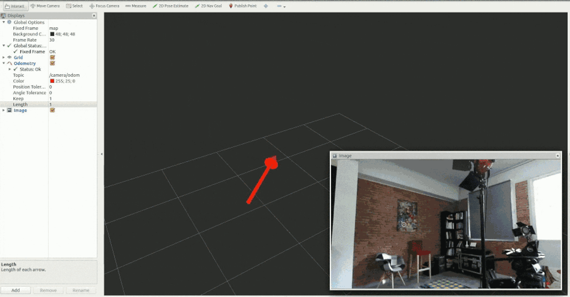

To visualize the odometry in rviz, click on the Add button (bottom left), and select the ZED odom topic under the By topic tab. To display odometry data correctly, make sure to select the newly created Odometry object in the left list, set Position tolerance and Angle Tolerance to 0, and Keep to 1.
