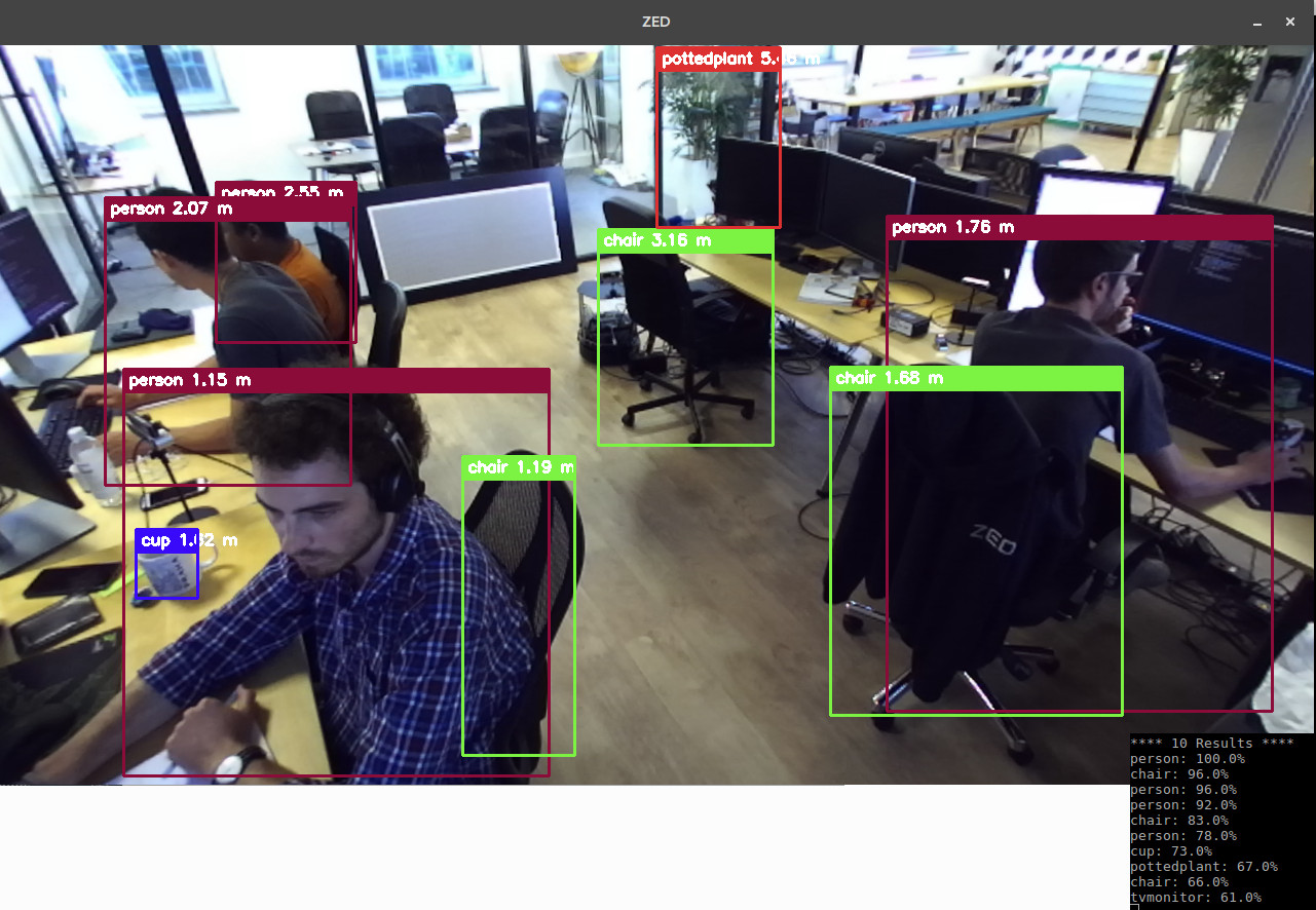

These samples are designed to run state-of-the-art object detection models using the highly optimized TensorRT framework. Images are captured with the ZED SDK to detect 2D bounding boxes using YOLO, and the ZED SDK then extracts 3D information (localization, 3D bounding boxes) and performs tracking.

  • The camera point cloud is displayed in a 3D OpenGL view
  • 3D bounding boxes around detected objects are drawn
  • Objects classes and confidences can be changed
