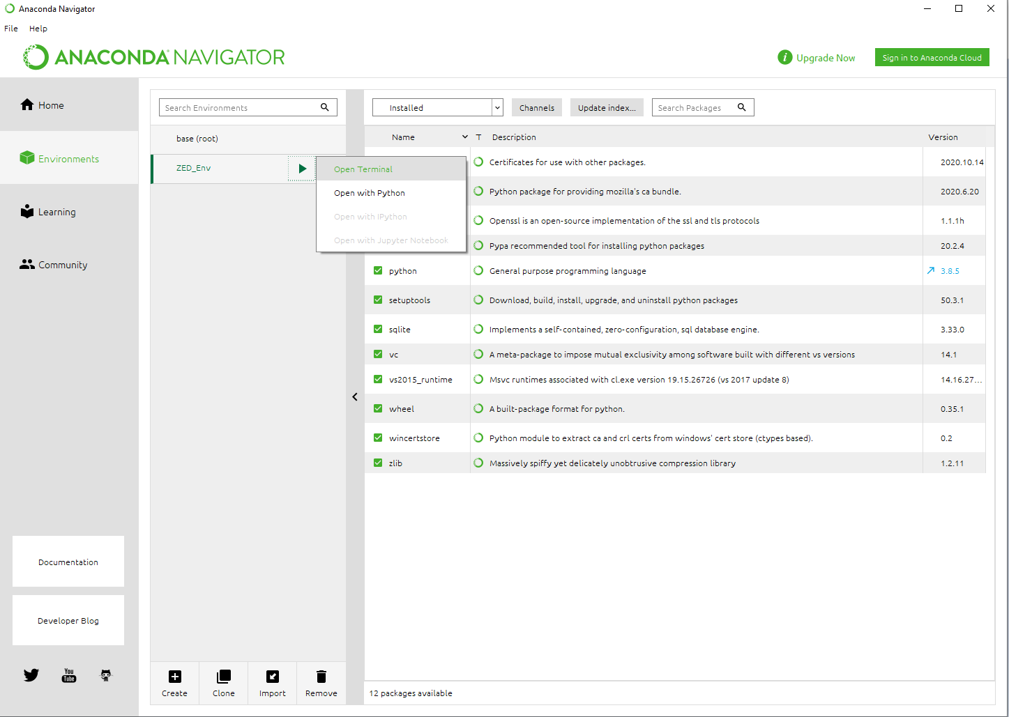

Create a new environment

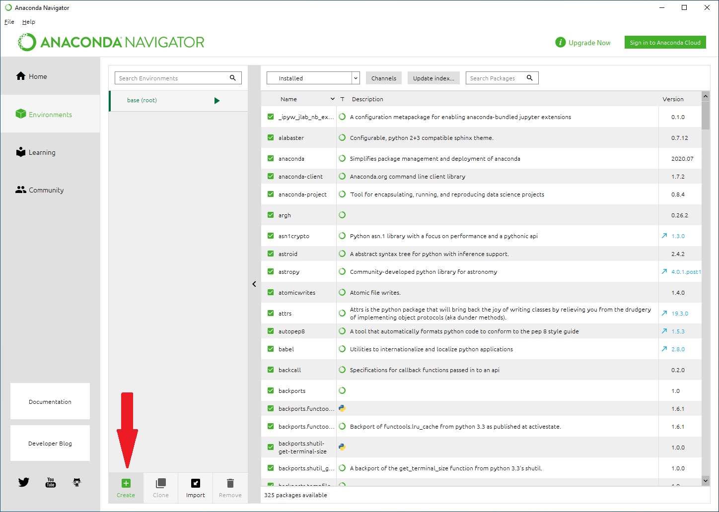

To create a new environment which enables you to use the ZED Python wrapper select the Environments tab on the left panel and then on Create in the bottom of the page.

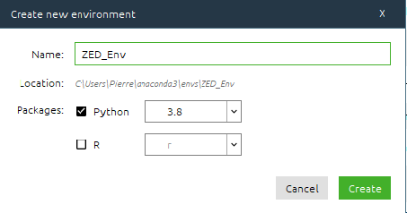

A dialog box appears, give a name to your new environment and click on Create.

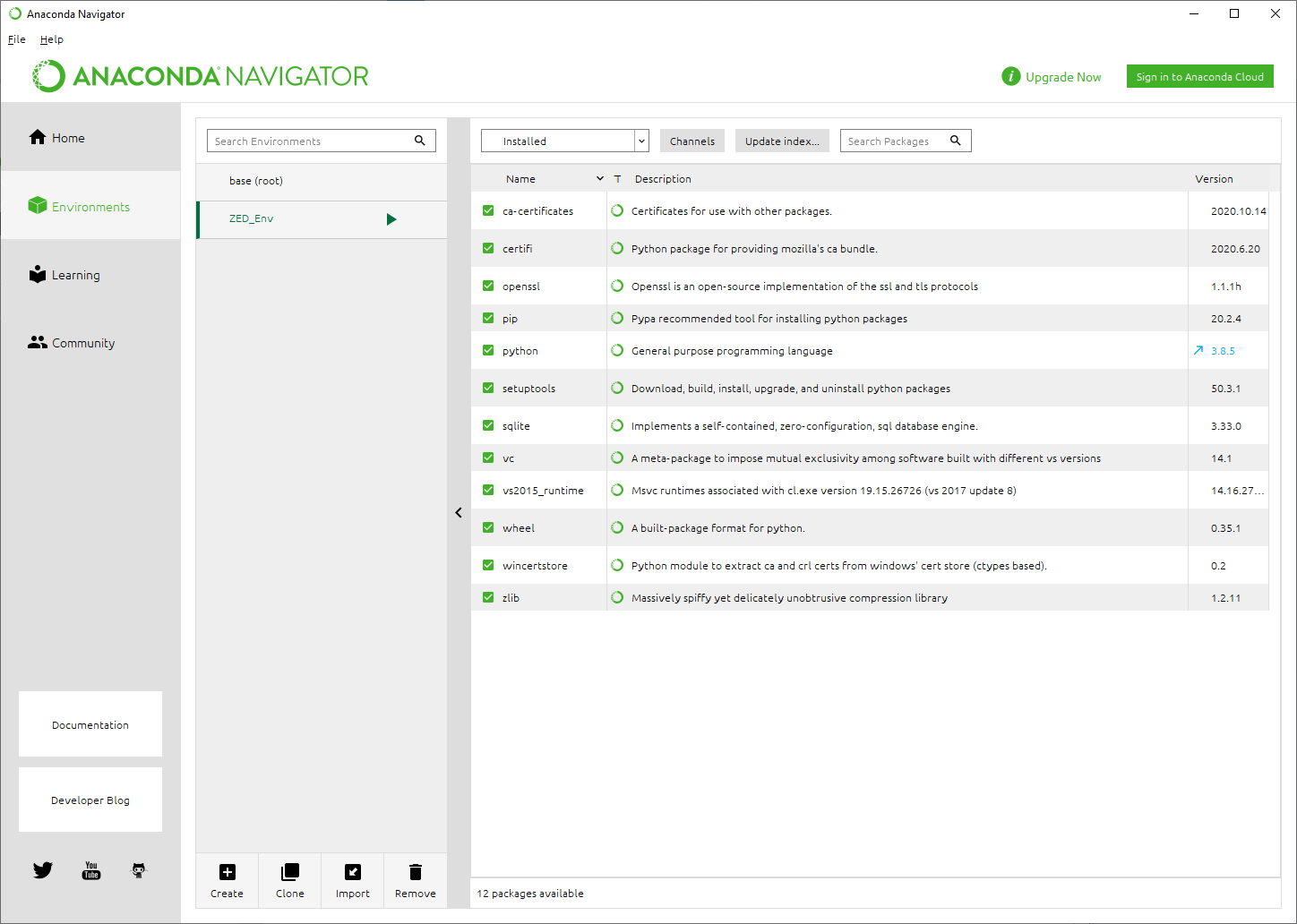

Your newly created environment is now listed below the base(root) one.
Add the ZED package
At this point, these instructions will be adapted to our needs, the main difference is that we want to install it on our virtual environment and not directly on the computer.
To do so, click on its name and then on the triangle to select Open Terminal.

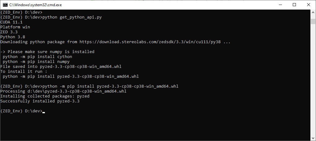

As said for the ZED package installation, copy the file get_python_api.py somewhere you can execute it without permission issues and then run it.

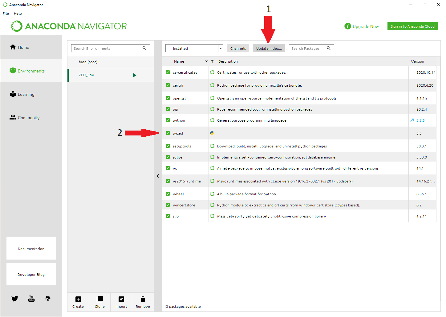

The ZED Package is now installed, you can close the Terminal. To be sure it is well setup, click on Update index.., the zed package named pyzed should appear in your environment.

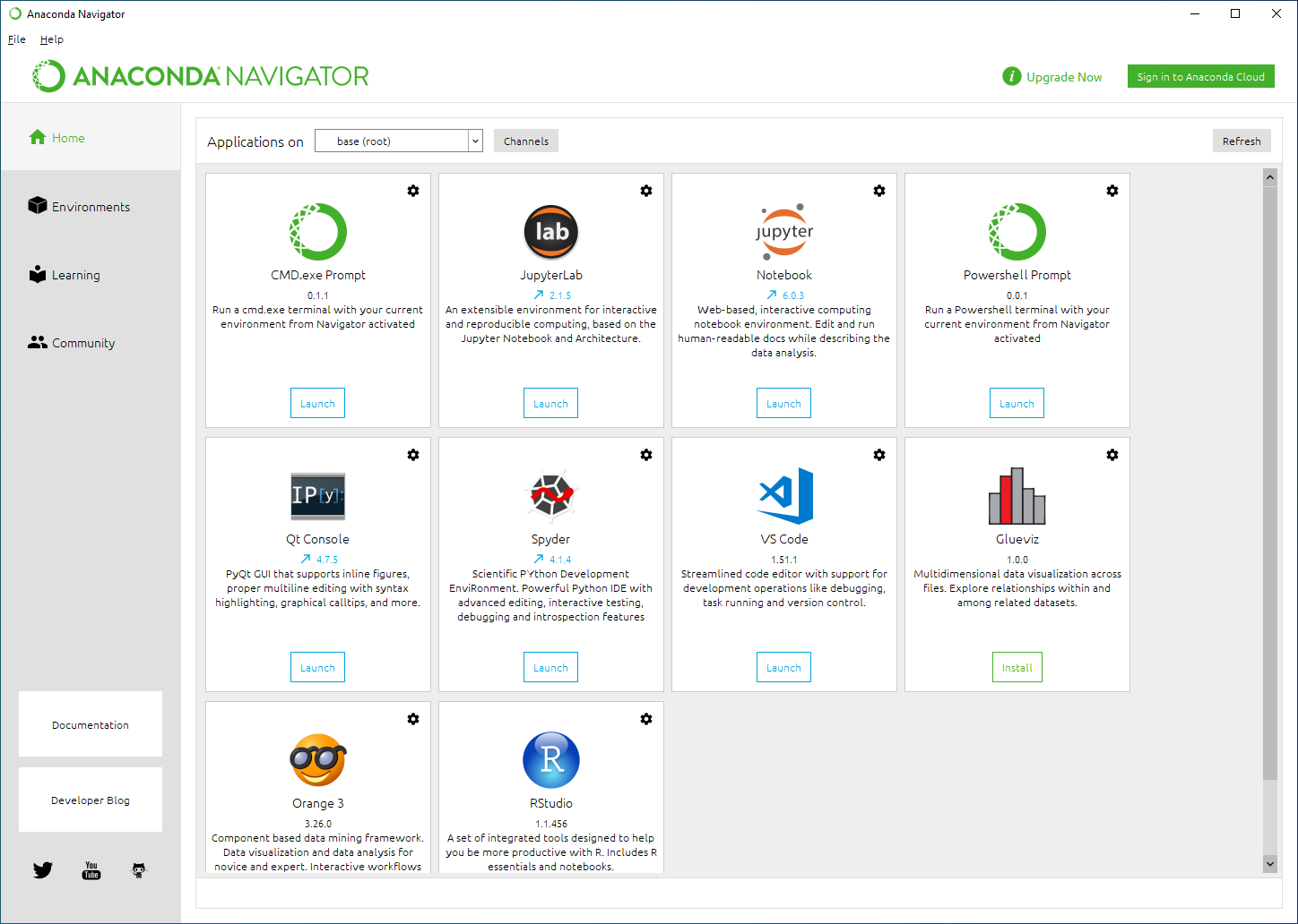

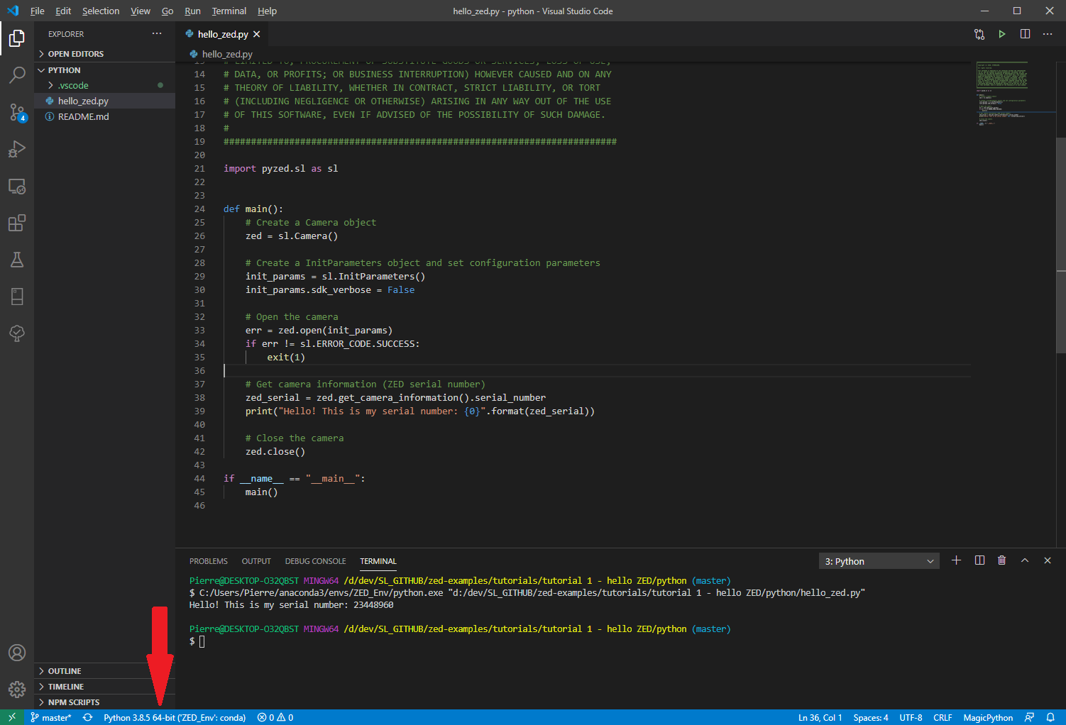

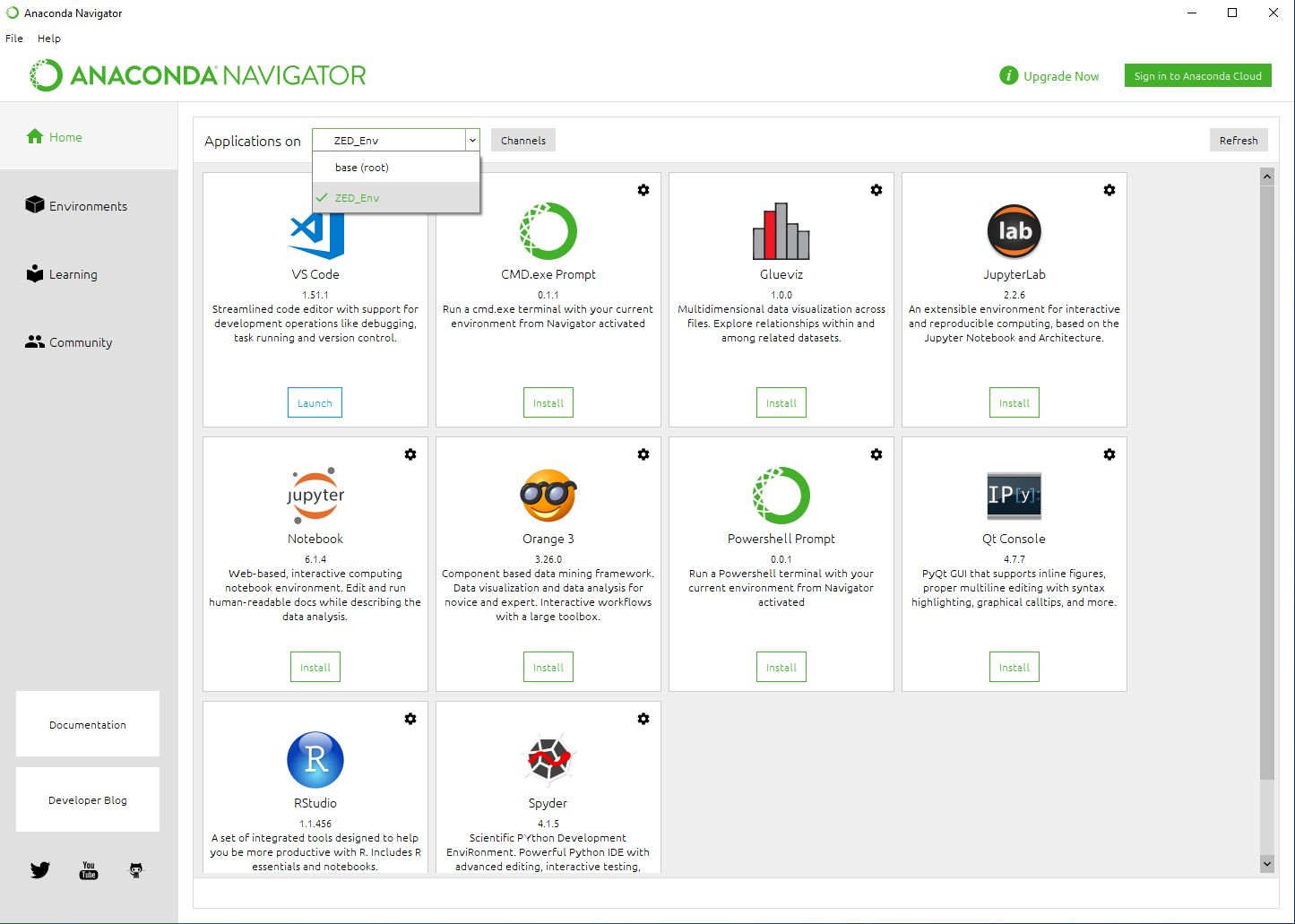

Go back to the Home tab on the left panel and select your environment.
Choose your preferred IDE, open a python sample, be sure you are really on your virtual environment, that’s all, you can run the sample !
