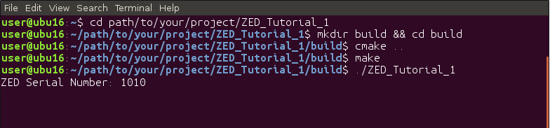

  • Open your terminal and go to the tutorial folder.
$cd path/to/your/project/ZED_Tutorial_1
  • Create a build folder.
$mkdir build && cd build
  • Generate your project with CMake by pointing to the CMakeLists.txt folder (the parent folder).
$cmake ..
-- Configuring done
-- Generating done
-- Build files have been written to: path/to/your/project/ZED_Tutorial_1/build
  • Use the ls command to check the content of the build directory:
$ls
CMakeCache.txt  CMakeFiles  cmake_install.cmake Makefile
  • Compile the application using the make command.
$make
  • The application is now compiled. To launch it, run this command:
$./ZED_Tutorial_1
The application will display your camera serial number in the terminal.
