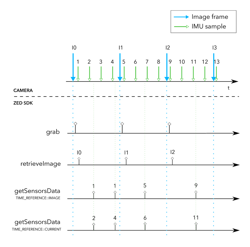

The Camera-IMU synchronization schema below illustrates what values these two settings return.
In the example above, we call the grab()
function and retrieveImage()
to retrieve the most recent image frame available from the camera. Then we call one of the two functions below:
getSensorsData(sensors_data, TIME_REFERENCE::IMAGE)
: It returns IMU sample “1” which was captured near image frame “I0”. We try to call the same function again before a new frame is available, and it returns the same IMU sample “1”.getSensorsData(sensors_data, TIME_REFERENCE::CURRENT)
: It returns the most recent IMU sample. We call the function twice and IMU samples “2” and “4” are returned, independently from grab call and image frame time.
