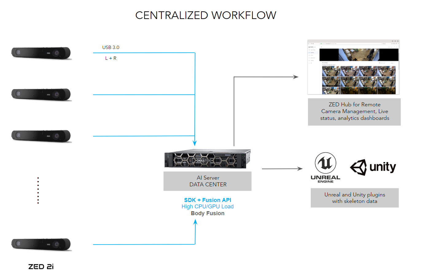

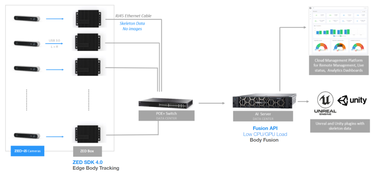

| LOCAL | NETWORK | |
| Presentation | Fully local application, where all ZED cameras are connected to the same host computer which runs the publishers and the subscriber. | Network (edge computing) oriented application based on ZED Boxes, where each publisher and the subscriber runs on different host machines. |
| Diagram | ![]() | ![]() |
| Pros | - Low latency - Efficient shared memory protocol (even for GPU memories) - Can achieve high FPS with high-end hardware - Simple setup for development | - High availability (no single point of failure) - No limitations on the number of publishers - Large variety of ZED boxes available to fit your computation requirements - Adapted for large scale scenarios - Remote monitoring of your system with ZED Hub |
| Cons | - Requires a powerful GPU (large GPU memory) to support the execution of multiple camera instances - Requires high USB bandwidth to connect all of your cameras - Can be limited by camera cable length | - Network data transfer introduces a small latency (< 5ms), depending on the network configuration |
